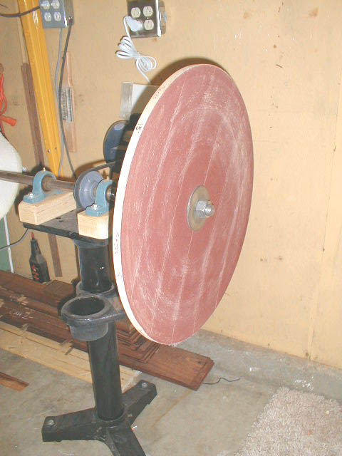

PostPosted: Tue Apr 25, 2006 8:12 am
Larry, you need a jackshaft for that big ol' sanding dish. A jackshaft allows you to gear down your speed while upping your torque, not that you need more torque, just a slower machine to sand with.
I thought of doing just what you did Larry for one reason, to allow the dust to remove itself from the premises without filling the cavities of the sand paper. It may be a non-issue, since I've not built mine yet.Bruce Dickey38832.7208333333

PostPosted: Sat Apr 29, 2006 2:33 am
The Jackshaft is a belt-driven speed reducing shaft.
Say your motor is going 1700 RPM and you put a normal pulley set up on it 2 inches to 4 inches, then your speed is cut. Insert a Jackshaft and effectively do it again, it drops the output rpms again.
We use this on the big sanding dishes to drop the speed to around 100 rpm, which makes it safer to use and gives it more torque.
If you want to see one, here it is.
For any newbies who haven't found the Jigs and Tools section of the OLF, go here:
OLF jigs and tools section
PostPosted: Sat Apr 29, 2006 5:25 am
Bruce, thanks very much. Do you (or anyone else) know of a book or other tutorial that explains a formula for doing this type of thing? I've got no experience with mechanics and I'd like to learn more.
PostPosted: Sat Apr 29, 2006 8:04 am
formula - its pretty simple ratios - take the rpm of the motor, say 1800, and on the motor is a 3 inch pulley. If you now drive a 6 inch pulley, the speed ofthe shaft with the 6 inch pulley is 3/6, or 900. If you use the jackshaft, or intermediate pulley (s), just do the same ratios to find your final rpm.
So for the picture above it would look something like this :
1800 rpm - 3 inch on motor to 12 inch on jackshaft, thus jackshaft spindle is turing 450 rpm. Looks like about 1.5 inch then on the JS to about 4 inch on the shaft driving the bowl - so 450 x 1.5/4 = 168.75 RPM.
